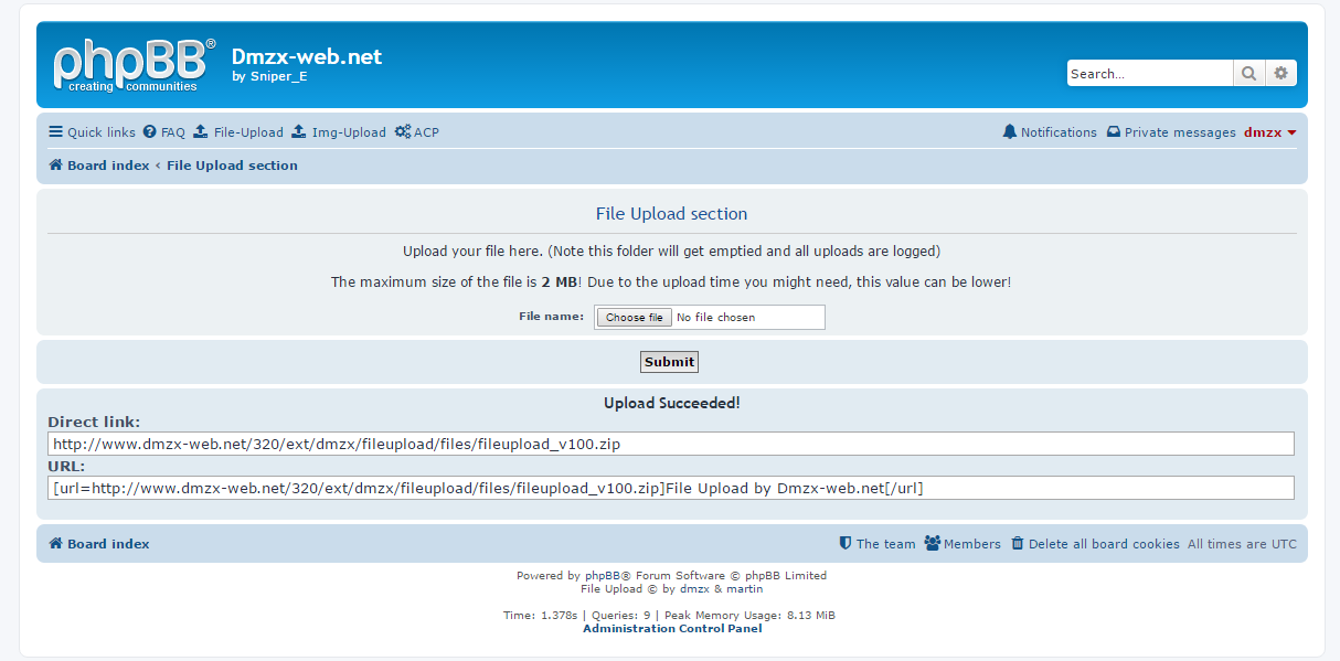

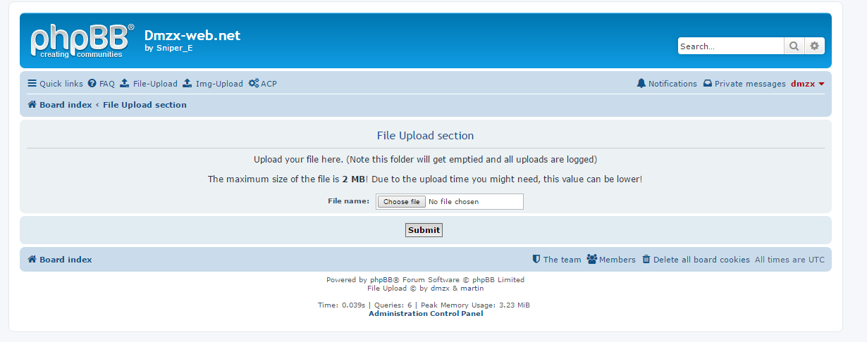

This extension will add an upload system for files to your forum.
This will allow you to host your own files from your server rather than use a 3rd party.
Allowed extensions 'zip', 'rar'

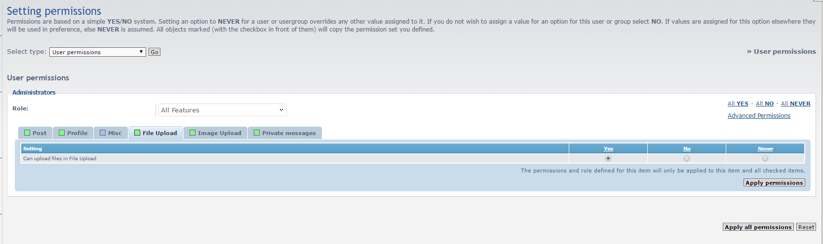

Set permission for groups, default only admin group can upload files.

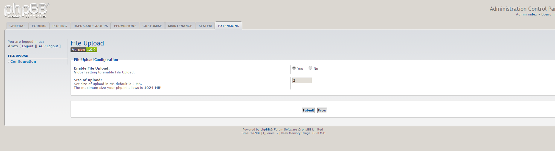

PHP Warning: POST Content-Length of 3879509 bytes exceeds the limit of 3145728
File upload time out the entire mp3 file did not make it you would need to edit your php.ini if you have access to it.

What are the values of post_max_size and max_execution_time in your PHP information?
Posts: 5143
1 given 1
Re: File Upload
Prob 30 seconds and thats not enough.
