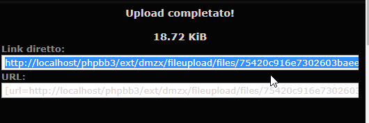

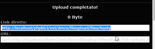

I understand the explanations regarding good coding, and issues related to files overwrites...
But I don't understand security issues for what Martin says:
ok, let's say Martin has an image/file with a nasty gift for my domain. He uploads it with the extension (modified by Dmzx). This is the result:
So, if Martin wants, all what he has to do is run phpbb3/ext/dmzx/fileupload/files/nasty.zip (as shown in the screenshot... The extension gives you the url) and bingo, my site is yours!
But if I leave all the things as they currently are, when Martin uploads his nasty file with the ORIGINAL extension, this is the result:
So, if Martin wants, all what he has to do is run phpbb3/ext/dmzx/fileupload/files/75420c916e7302603baee.zip (as shown in the screenshot... The extension gives you the url) and bingo, my site is yours!
So... Where is the difference? Where is the enhanced security?
Ps for DMZX: your PM works perfectly. It seems not working the ACP control panel (not deleting files in directory) but that's really NOT a problem for me! Thanks a lot for your help!
