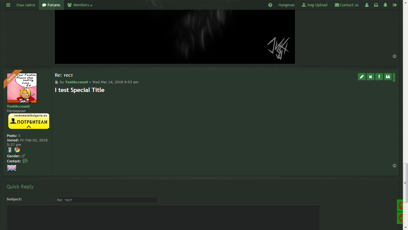

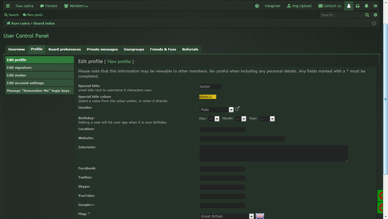

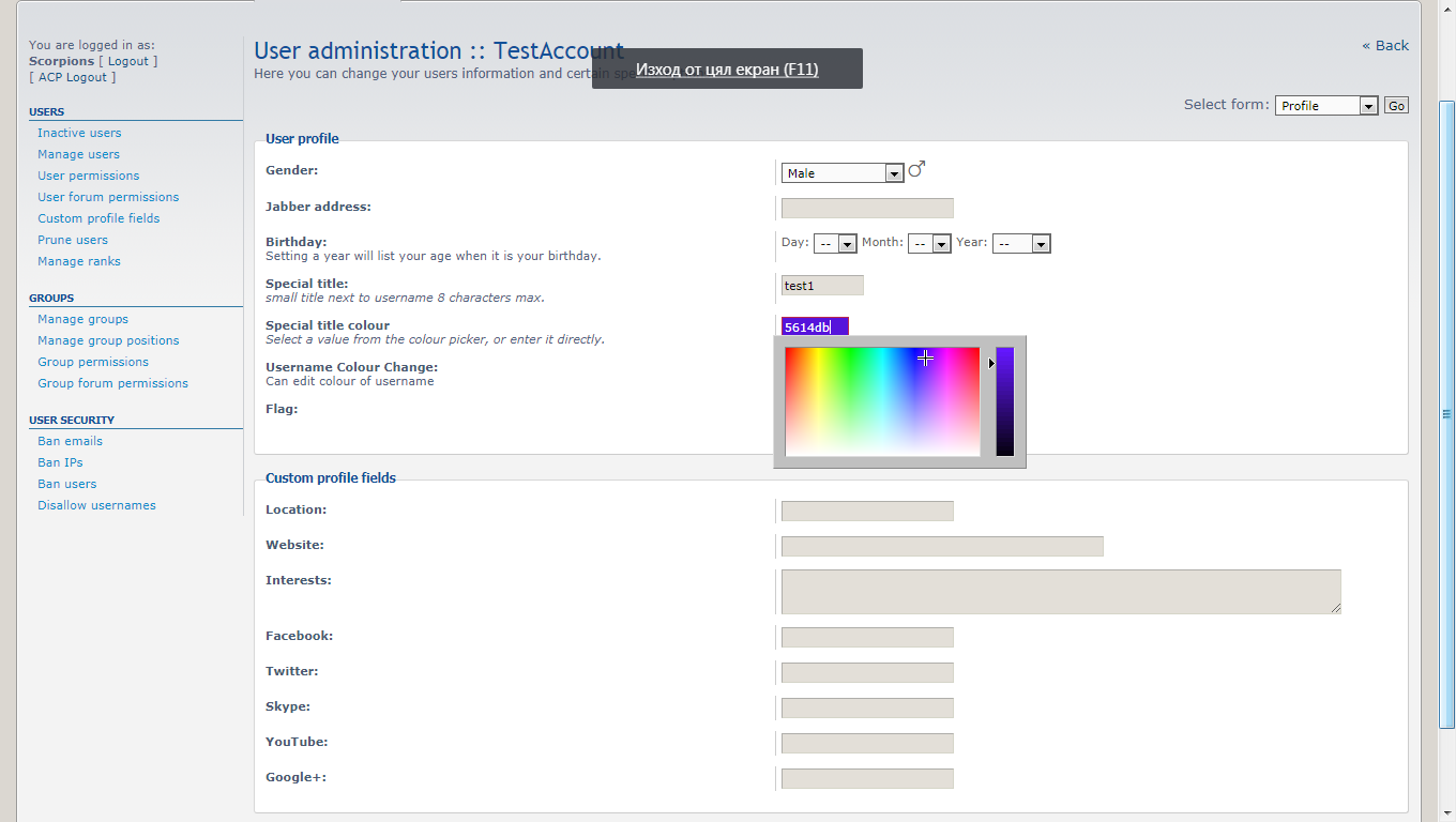

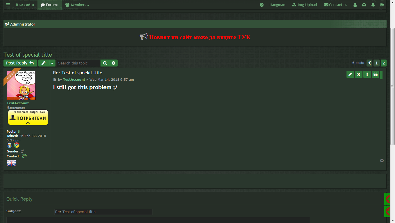

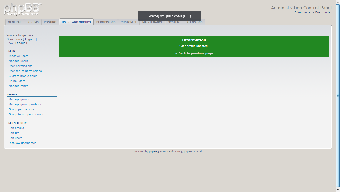

Can anyone help me with my problem?
I tested it on my test board and saw same problem.. :yikes:
i also suspect that maybe only admins can put this on their names event the registered users can use this thro user control panel and they can't put it on the name and event i set the permission up on the registered users
and um..when the admin user group i made deffault for test user (for example) then it have special title
