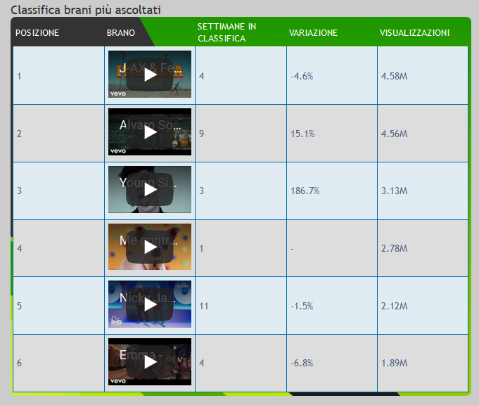

Hello everybody,
I wanted to ask a question
I created this table, clicking on the video remains small, there is the possibility that when you click on the video you zoom in or open the link on youtube?

I thought we tested and video bbcodes do work inside tables. How are you inserting those videos in there? I'll test that.
The video will stay that size until you click full screen button. Unless you have an extension that will bring it up front.
You set the size of that video with the width of that th. Give it more width and the others less width.

Hi Sniper, now i understand,
I entered the video only by putting the link to the video
if i click play on the video does not give me the ability to click to put it in full screen, because it is too small
I installed the extension, open in new windows but does not open the video in another window because i can only click on the play arrow.
I will try to see to set the size of the video.

I was saying in the other post that this would make the video larger.
[th=10,null]
[th=60,null]
[th=10,null]
[th=10,null]
[th=10,null]
Try those numbers.
But I see you have long text in that third column. But the content below it is one character.
I'm not sure what to tell you there.

Hi Sniper,
now a little bit is better, now you can click on the name of the video and take you to the page on youtube, for now it's okay
The text in 3* column is weeks in the standings which in Italian is long.

Then make Tha 3 one bigger if you need to. Adjust the widths to make it look right to you.
Adjust the others down to 5 and center the text. Replce null in td to textcenter .
Make each one as small as you can and give the rest of the 100% to the image.
You control the look of your posted table.
I adjust my widths and Preview. Adjust again until it looks right an then submit.
You have it from here.

Also look at the codes in the top of textarea and make the [table=98,null] to give you max width for the video.
