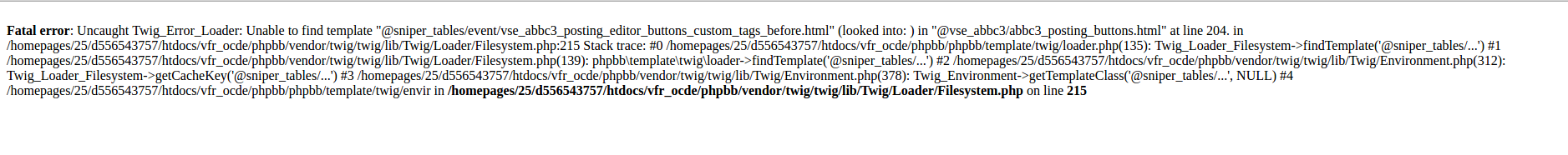

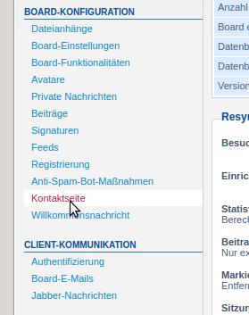

If I want to open the contact page, ext/dmzx/imageupload/files/2518e822947c ... 49350b.png
I get the following error displayed: ext/dmzx/imageupload/files/b15c7f699147 ... 344202.png
Board is running on PHP 7.1.6, Advanced BBCode Ver:3.1.4 is installed
I've opend a support ticket.

Have you tried clearing your boards cache? A lot of TWIG errors resolve after the cache is cleared.

i confirm this behavior in ACP. On my board i have a blank page one time in two, i have to purge the board cache. It is very disturbing.
I suppose vfrblue has the error displayed because he activated the DEBUG mode in config.php. I willl test also if i can retrieve those same errors.
This issue concerns only the ACP area, on pages where the complete text editor appears.
To reproduce this problem you have to install a vanilla phpBB 3.2.x board, install the last official extension of ABBC3 and the “Tables” extension.
An other example of page where this issue appears, with the “Page” extension when you create a new page or edit a existant page.

What's new?
Posts: 1157
Re: Tables 3.2.x
There is a new download for Tables 2.1.1 on the first page and at .com
Galixte found a couple of bad event templates that were causing a mess of problems.
He whipped a couple of new event templates up and we're running again.
I still have not got around to updating to 2.1.2... but in time

edit: Sorry, no change :cry:
Posts: 1157
Re: Tables 3.2.x
No? Try https://github.com/Sniper-E/tables
No change? What's wrong? Was my download link bad?

I tried both downloads and the erroe is the same:
The error appears when you open the table in the posting and then open a posting editor again in the ACP. After the error message, the table icon in the posting editor is no longer displayed by the forum. (Google Translator :whistl: )
phpBB-Version: 3.2.1, PHP: 7.1.7

Of course there's nothing fixed, only this: https://github.com/Sniper-E/tables/comm ... 3a16b0319e.
@Sniper_E, I think you have missed some informations so i'll resume for you: https://www.phpbb.com/community/viewtop ... #p14787406. ;)

vfrblue wrote: 22 Jul 2017, 12:18 i tried both downloads and the erroe is the same:tableserr.png
It’s temporally but, did you try the workaround ? To purge the board cache before accessing to this kind of pages (ACP pages where the complete editor text should appear).

I've purged all caches, deleted the codes from the BBCodes in ACP, deleted the "tables"- folder via FTP and copied the new "tables" int the "ext."- folder.
Then I installed it new.

I'm trying to see why that error is showing up. I see now, had to refresh my cache also to correct the blank page going to textarea in ACP.
