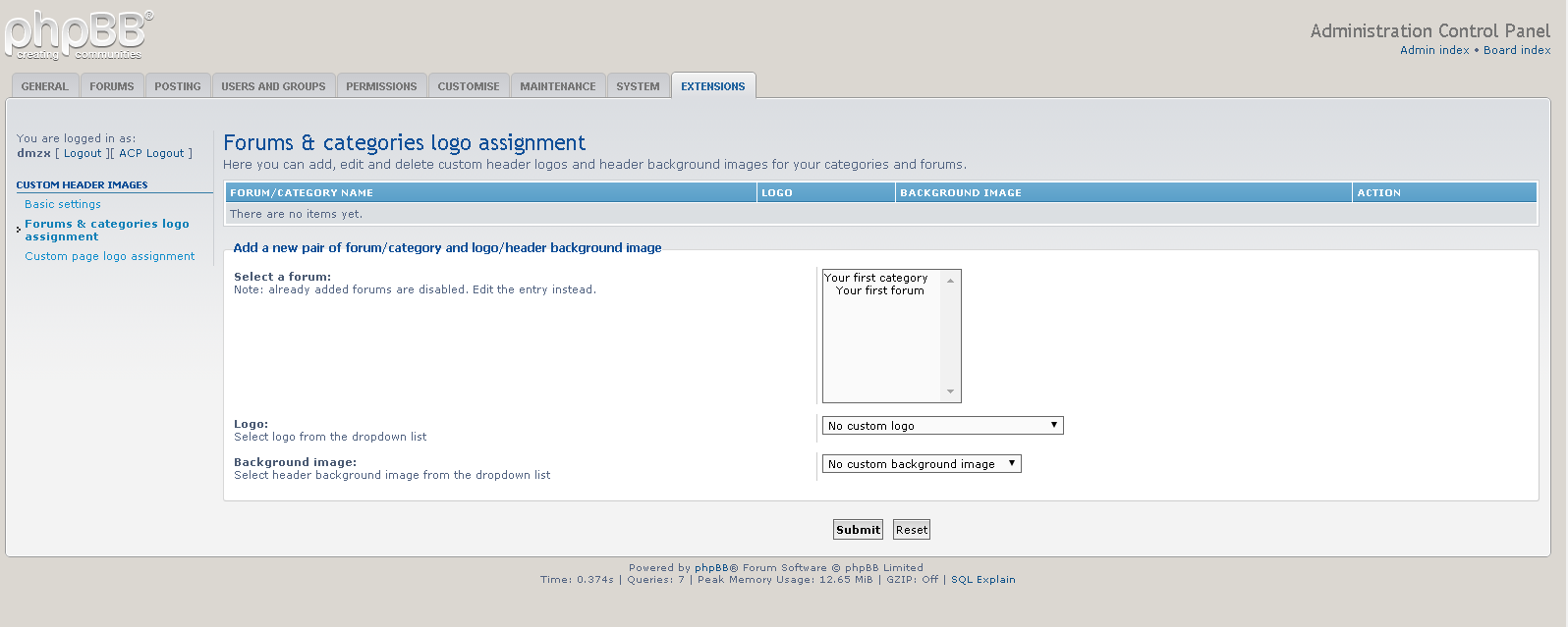

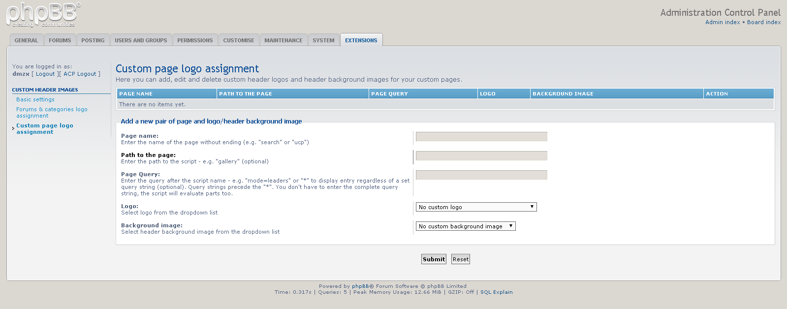

You pretty much have to assign the bg image and logo to every page.seacoast wrote: 05 Apr 2019, 20:21 Great extension, but how can I get the bg image to stay for my whole board? Do I have to define the bg image for every single page?
I have it on index, then I go to UCP and get phpbb logo. Am I doing something wrong?
These links may help. They are in the Custom Header Logo for PHPBB 3.1. All have to do with the ACP, Extensions, Custom Header Logo. Forums & categories logo assignment and Custom page logo assignment. It may help to look through that whole topic.
Have fun ...

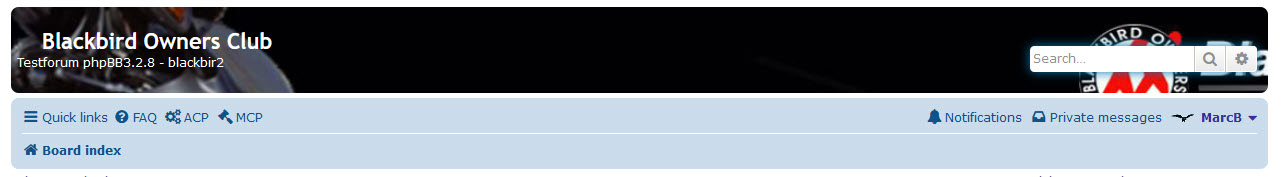

Thanks Sniper_E and sorry for not being clear. I setup a test board, implemented "Custom Header Logo 3.2.x" and changed the settings as mentioned by you.
If you make the browser view smaller, the banner width stays within the margins of the forum but, the banner itself is not automatically resized. I mean, the full Banner is not shown with different width's of the browser view.
This is how the Banner looks on the test forum

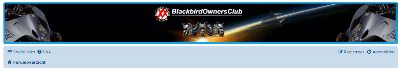

Below shows how it should look

Well buddy, this ext is setup to give you different background images and site_logo images on different pages.
And all of the sizes deal with pixels for the width and height. This extension will not work for your project.
Now if there were enough of you that would want a different full width banner image on the different pages then I could heavily modify this Custom Header Logo 3.2.x extension and make it work. But if I were to spend all that time re-shaping this extension for that, I'm sure dm would place it in the VIP forum. Would you and maybe a few others want to donate here for me to create this special extension for you? Or do we have enough donors here already that would be interested in this page selected full banner image extension? You guys could push into spending that time also.
