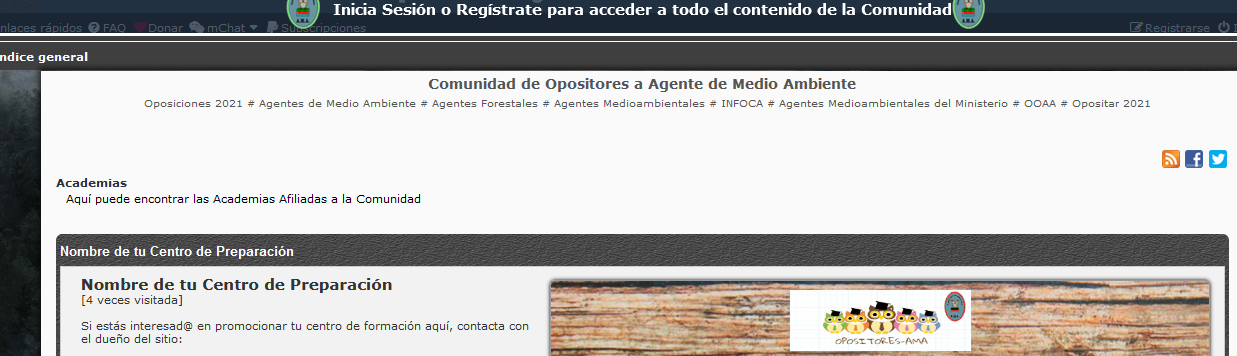

I figured it out, but this button is not visible here, which is in the picture. How to make it display for guests?
How do I make the application form visible to guests?
Posts: 1160
Re: Partner Page
There are two settings in acp/permissions/misc tab
If you have both set to yes for guest you're good
But in the template/dm_partners_body.html on line 49 it has an if statement that stops guest from seeing that button
Remove the "and S_USER_LOGGED_IN" part and it will show for guest
But I'm not sure the add partners page will let guest add one seeing how guests can not post in your forum. They will most probably be sent to a login page so they can post.
