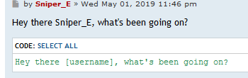

The bbcode this ext creates in acp / posting is set to no show in posting. That bbcode should not show in posting.There are event templates that create a username bbcode icon that inserts [username] into the textarea.
It works in mchat also but the page has to be refreshed for the name to show. Or someone can join your server after you posted it in mchat and they will see it because their page has to load.
In Posting, the page has to refresh on preview or submit so it works fine there. But if you see some changes to make it work better that I don't see... share!
