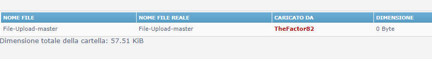

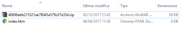

No, it's works in this way:
on ACP I can see file names:
(you can also see that file size is 0 bytes).
But in "files" folder, the file is uploaded with "generated" filename:
What I need is that the file remains with original filename...
