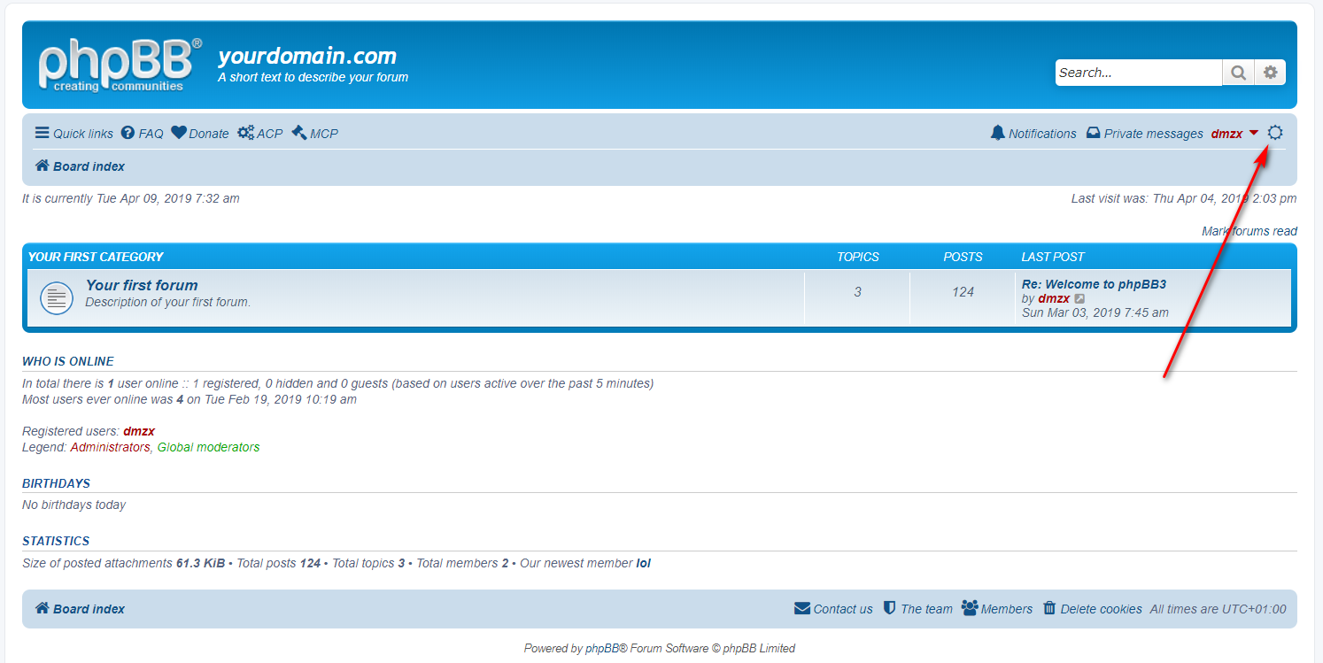

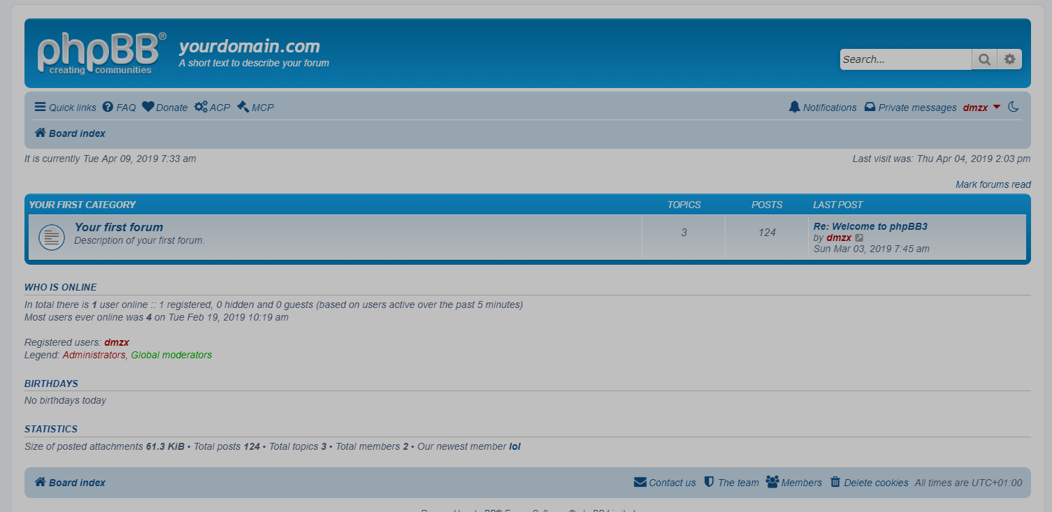

Extension Name: Light-Dark Extension
Author: dmzx & martin
By the idea from martins's Dark / Light style changer.
This extension will change brightness for now, It can be adjusted to whatever style you need in file:
ext\dmzx\lightdark\styles\all\theme\lightdark.css
ACP control included.
