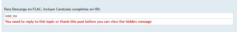

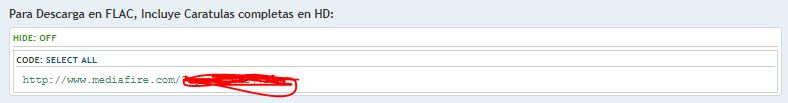

I will show that to him. But I think he is attempting to have members NOT post a thank you and instead use the "thanks for posts' extension.
EDIT:
Ok, I was mistaken - guess I should have read the REAME first. :wall: :wall: :wall:
I installed on my development site to test and it appears to due what he wants it to.

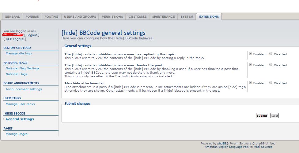

From the README:
With the [[hide] bbcode][5], members can hide their message content from people that haven't posted in their topic. One can also choose whether or not attachments should be hidden.
Compatibility has been added for these extensions:
 * [Thanks for Posts][1]: You can choose in the ACP that people can also (or only) unhide [hide] codes by thanking the user for the post. Thanks on posts containing a [hide] code may not be deleted.
 * [Quick Reply][2]: When needed, page reloads after a quick reply.
Caution should be taken with these extensions:
 * [Topic Preview][3]: This extension [seems][4] to display the hidden text by default. You can disallow the BBCode to show up in the ACP of Topic Preview.
## Installation:
 * Copy the contents of the extension to ext/marcovo/hideBBcode/
 * Install the extension under ACP -> Customise -> Manage extensions.
 * Configure the extension under ACP -> Extensions -> [HIDE] BBCODE -> General settings
