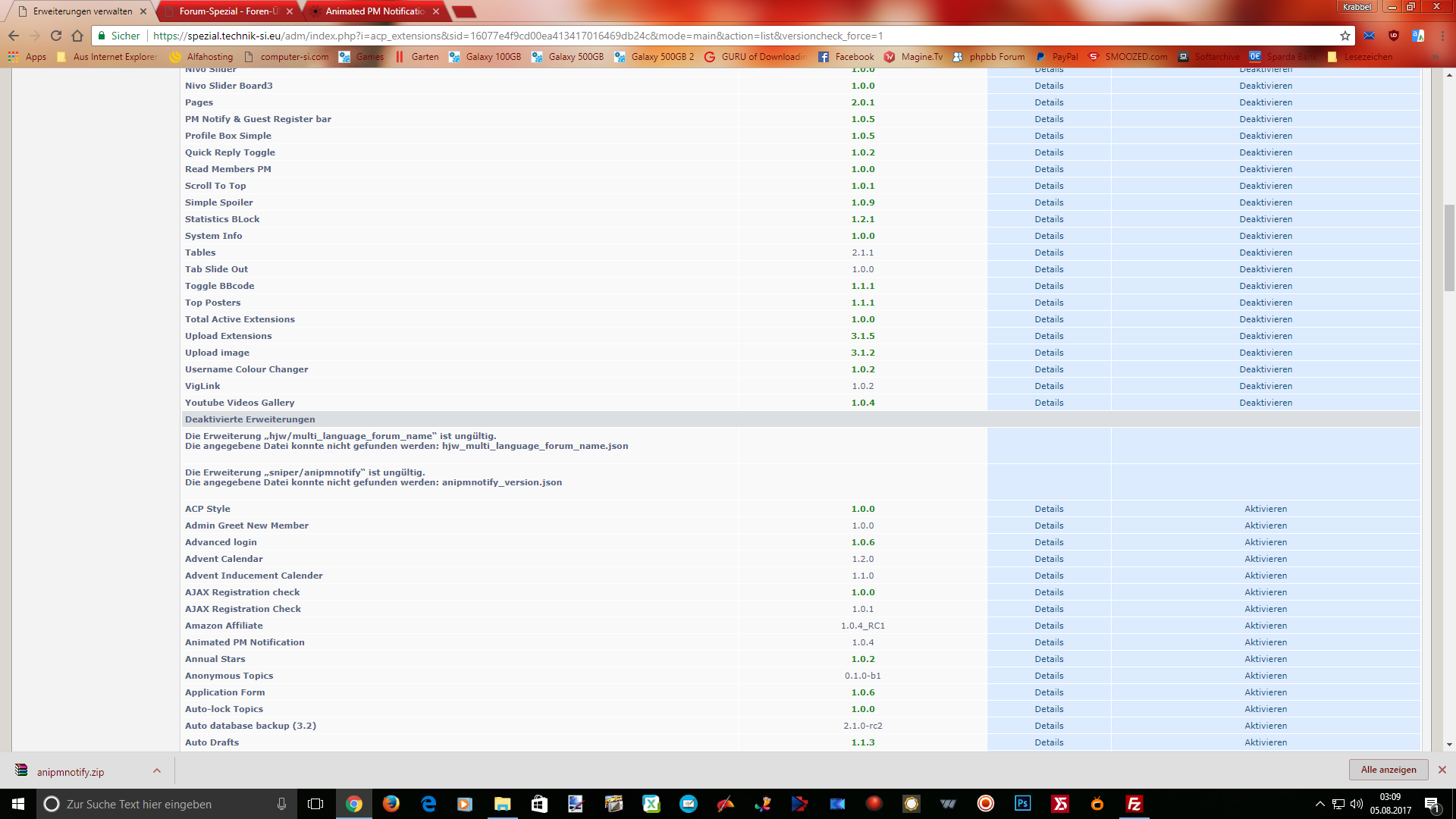

Have the extension Animated PM Notification 1.0.4 installed. If I go to actarize this error comes
How can I fix this error?
mg Funny :eyes2:
Posts: 1159
Re: Animated PM Notification
I fixed that error for you Funny. Try again.

Looks like a bad install or update error to me ie ext installed and then new files uploaded (that needed to be unistalled first) then when on activating you get the bla bla bla file cant be found.
Posts: 1159
@martin it was my ./versions/anipmnotify_version.jason file missing. I put it back on my server now. That error is gone.
