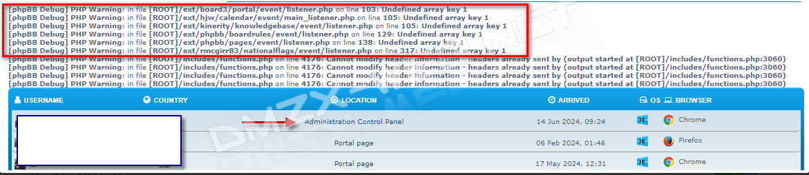

The Who Is Where extension shows PHP warnings the moment my location changes to APC. If I navigate through the forum pages, no warnings appear.

The problem occurred after switching to PHP 8.3
Before this I was using PHP 7.4

check the extensions in red above.

If I change the code in the extensions and add a variable check, then everything works. For example:
if ($event['on_page'][1]if (isset($event['on_page'][1])
However, among the problematic extensions there are also official ones from the phpBB: Board Rules and Pages. Thus, it seemed strange to me that they are all incompatible with the new version of PHP.

Yes the official extensions need to get updated.
