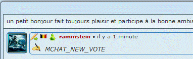

I have a language problem ??
'MCHAT_NEW_VOTE ' => 'à voté dans le sondage : %1$s in %2$s',

The problem is i see this is french, the ext seems not to have french language.
You can either translate it on your own, or you just create a french directory in the language folder of the ext, and copy the english lang files in it, so your ext will work, but shown in english.

Quick fix but must be done in mchat:
notifications.php
$notification_lang = [
			'MCHAT_NEW_POST',
			'MCHAT_NEW_QUOTE',
			'MCHAT_NEW_EDIT',
			'MCHAT_NEW_REPLY',
			'MCHAT_NEW_LOGIN',
			'MCHAT_NEW_POST',
			'MCHAT_NEW_QUOTE',
			'MCHAT_NEW_EDIT',
			'MCHAT_NEW_REPLY',
			'MCHAT_NEW_LOGIN',
			'MCHAT_NEW_VOTE',
Or wait untill he updates his extension.

Ok thanks it works
